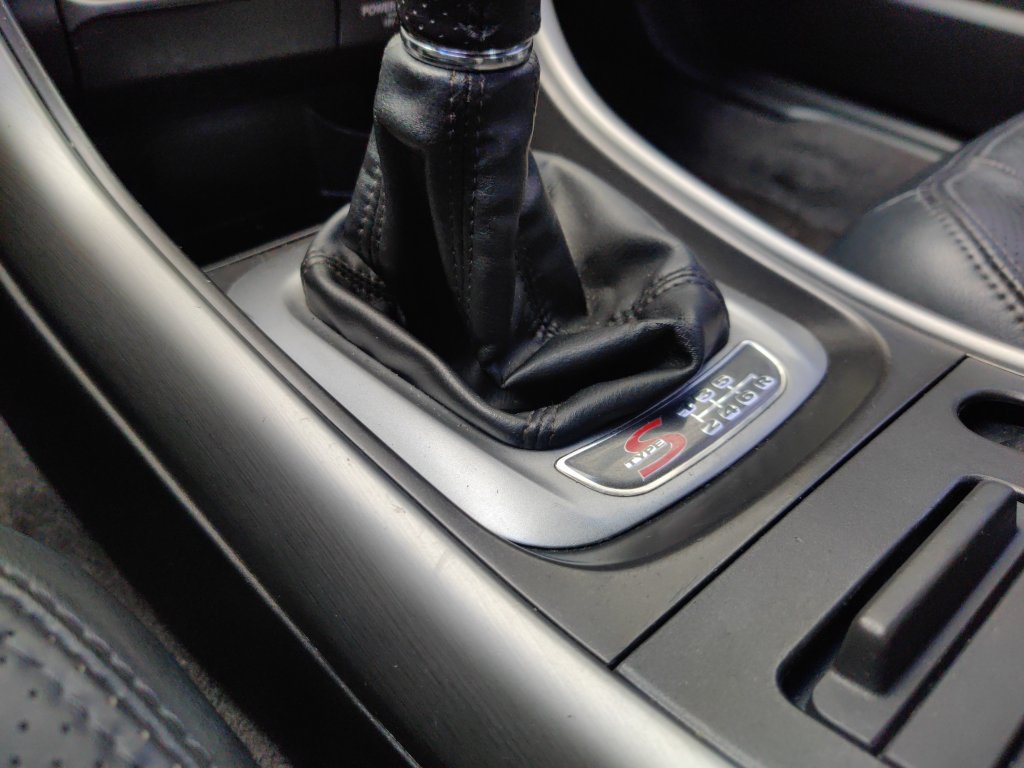

    Been a while since I posted some pics of this car.. I remember my old man told me once: "Operating automobiles originally meant to be MT back in the day. It was until someone in a military came up with this brilliant idea of getting crippled soldiers to be able to drive their vehicles on duty.." Well, AT is becoming today's standard, but I guess it was for disabled people in the beginning.
    [​IMG]
    Saw the runners made by P2R and I was wondering which part it exactly replaces the factory parts.. :thinking: Which upgrade is it incompatible with S/C?
