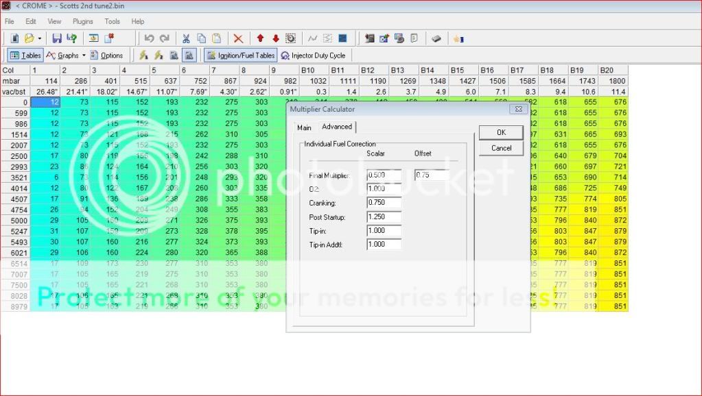

here are some screenshots of the window. Basically it allows you to tell the computer that you are running larger injectors in a larger engine. For some reason it doesn't keep the 2254cc that i type in. If I put 480cc injectors and 2254 engine displacement it gives me .707 as a fuel multiplier. but since it doesn't save the 2254cc part it read inaccuratley so i just use the 480cc and that gives me a .5 fuel multiplier. The offset doesn't do a whole lot from what ive been able to tell.
This link explains it a little bit. http://www.xenocron.com/install/CromeGuide.htm
"Fuel Tools is a recent plug-in addition that makes tuning vehicles using non-Stock Injectors MUCH easier. I recommend you use in even on vehicles that are using stock injectors if other parts of the setup are highly modified.
Add Fuel Tools and then move on.
Because we are using 450cc injectors, you need to put 450 in the New Injector Flow Rating…notice that the adjusted multiplier has changed to .533. Click on the Advanced Tab and continue…
Fuel Tools 2.0 allows you now to store your fuel multiplier value. This multiplier takes the numbers in the Fuel Map and applies this multiplier to them before the ECU does its final Injector Pulsewidth calculation and squirts fuel into the motor. This fuel multiplier is powerful because motors generally have a shape or a curve to them, and when we change injectors, the motor stays the same so the curve should stay the same (figuratively). Different brands of injectors will have different properties that will slightly change this curve though which is also why that OFFSET box is now there…this will be explained further in a moment.
With larger injectors (than stock), we must also modify how the motor cranks, starts and adds fuel when the throttle is depressed (Tip-in). O2 sensor trim can be modified as well but on most tuned vehicles, we aren’t enabling the O2 sensor so I will not go into that option box. You will find the numbers you enter in these boxes depend highly on the injectors but will also be affected by cams, throttle bodies and even things such as how strong your alternator or battery are as well."
