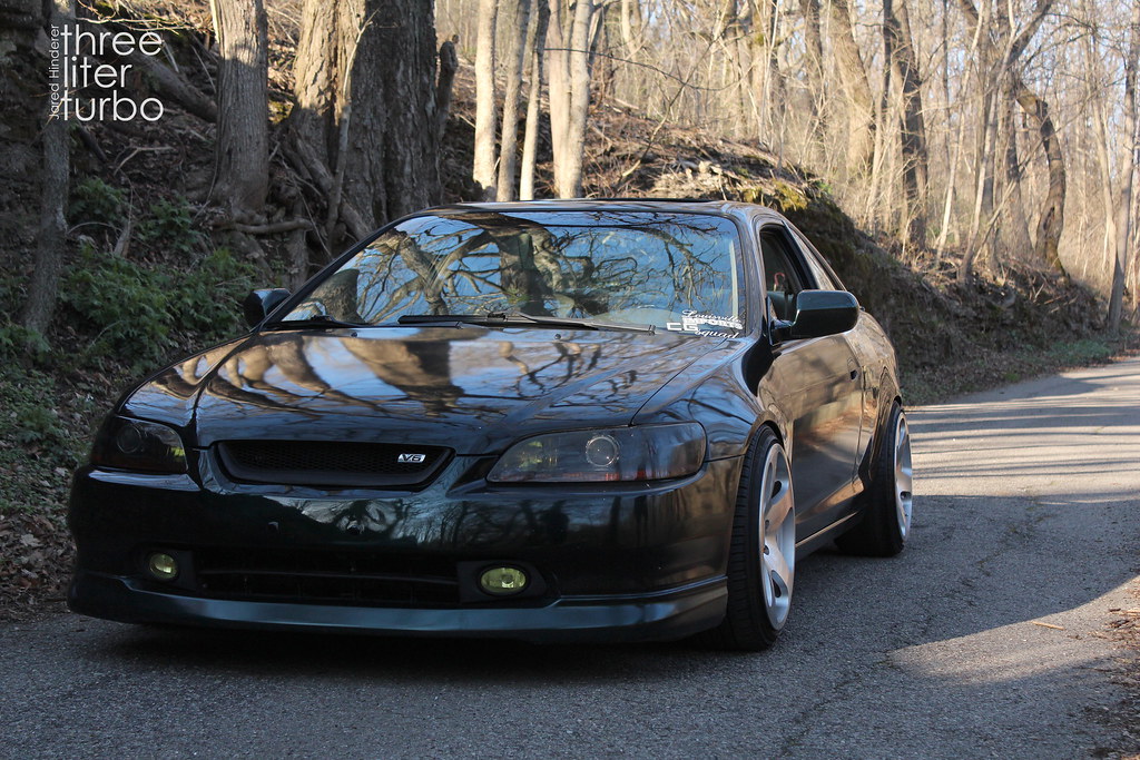

I'm running 18x9.5 +25 with a bit of stretch on 215/40/18 with Tein SS. I'd like to go just a bit lower to pull off the fitment just a bit better, but maybe this gives you a good idea. All fenders are rolled/ slightly pulled.
Accord in the woods by Three Liter Turbo Photography, on Flickr
