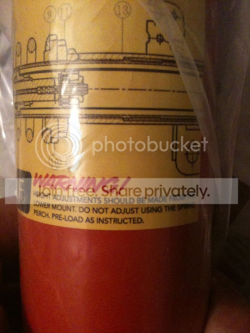

umm this might be a stupid question but i looking at my coils and thought..how can we twist the bottom red part to adjust hieght when arent they going to be screwd in so the bottom wont move?

Actually the correct way to do it is to loosen C and turn A with the spanner wrenches. You don't even need to loosen the 14mm to adjust the coils.
That's how I adjust mines and that is the way Ken(NaSOHC) advises to do it.
It DOES NOT affect or adjust your spring load, so you don't have to worry.

that doesn't make sense :squintrun:
this is what it says on mine
chriskarel
Jan 16, 2009
160
USA
mine says that too. JDM I just e-mailed FF, I'll let you know what they say. lol
